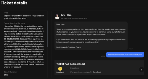

For others future reference. I got the funds credited to Gate by reopening a ticket and using the ticket type (urge crediting of deposit with correct information).
Grim wallet sends the amount you enter + the fee separately, so the recipient receives exactly the amount you enter into the wallet interface. Turns out I sent the exact correct amount to Gate, including the 8 decimal places after the decimal point they want to use as the Memo ID.
For others’ future reference, the TXID they want you to input in their support form is the Identifier (not the Kernel) but you should also provide the Kernel to them separately in the notes, and explain that they should a) search for the transaction on their node using the Identifier (Shared Transaction ID) AND b) search for the transaction on the block explorer using the Kernel.
