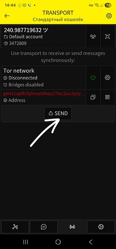

I really had 2 wallets. 1 on my PC and 2 grim android. I never think that if I send coins from 1 of them it’s not synchronized
Ok that explains it then, means one of your other wallets sent the coins and should have the tx kernel. So even though you hit cancel on one wallet, the other wallet still sent the coins.

I sent to gate several times, but this time it stop and asked me to confirm the transaction, so I cancelled. There is no tx on second wallet, and during that transaction it wasn’t working, because node wasn’t synchronized.
Maybe if you sync and then repair the second wallet instance it will show up now that it’s synced? I hope someone smarter can help you I’m just giving me two cents. i wonder why gateio asked you to “confirm it” maybe you still need to confirm it so it’s held by gate io but not in your gateio wallet.
