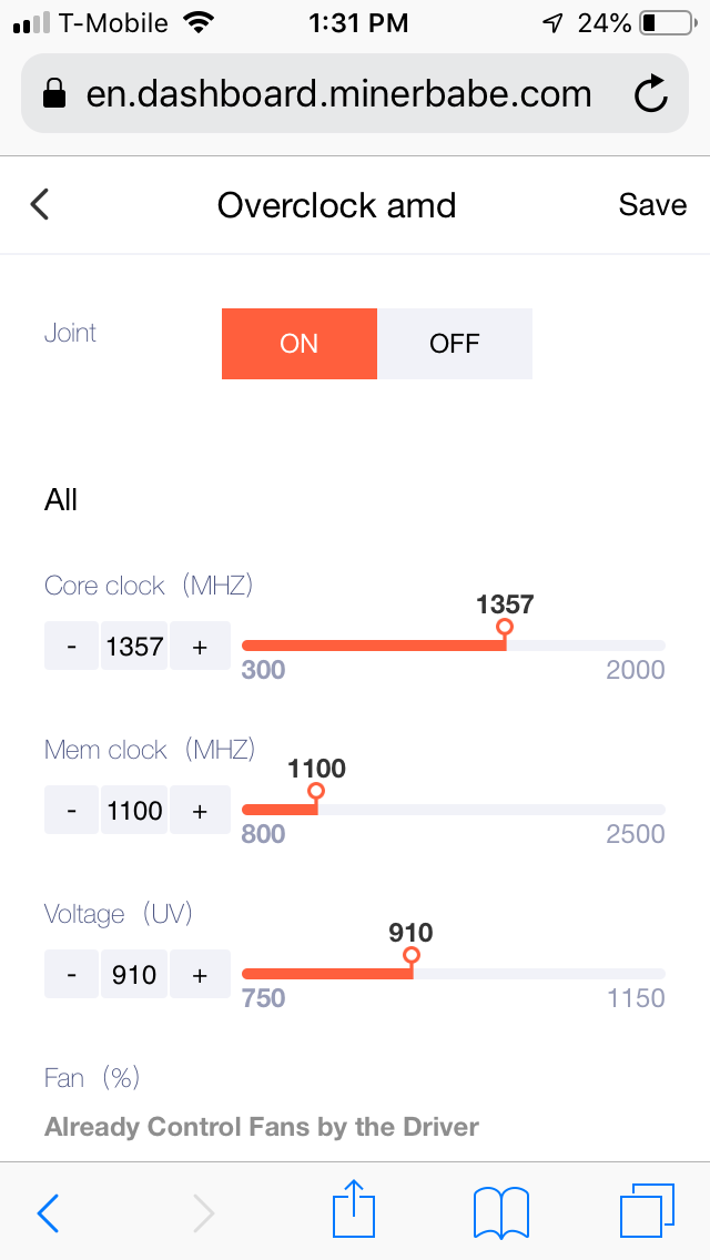

I have 12 Vega Frontier Editions running Minerbabe 4.12. I created some overclock templates, but not sure how to assign that to my GPUs. I see its using 1408MHz/1100mv core, 945MHz/1100mv mem. Those 1100mv are too high. I rather chosen my own overclock templates.OverclockingTemplates

I saw this on my phone, but not on the pc.
Needs two mV sliders, one for core and another for memory.
This help for crap cpu’s , thx !
Found out how to use the overclocking templates.
Select Rigs.
Select the rig you want to change.
Select the “Batch Overclocking” button.
Select the overclocking template.
