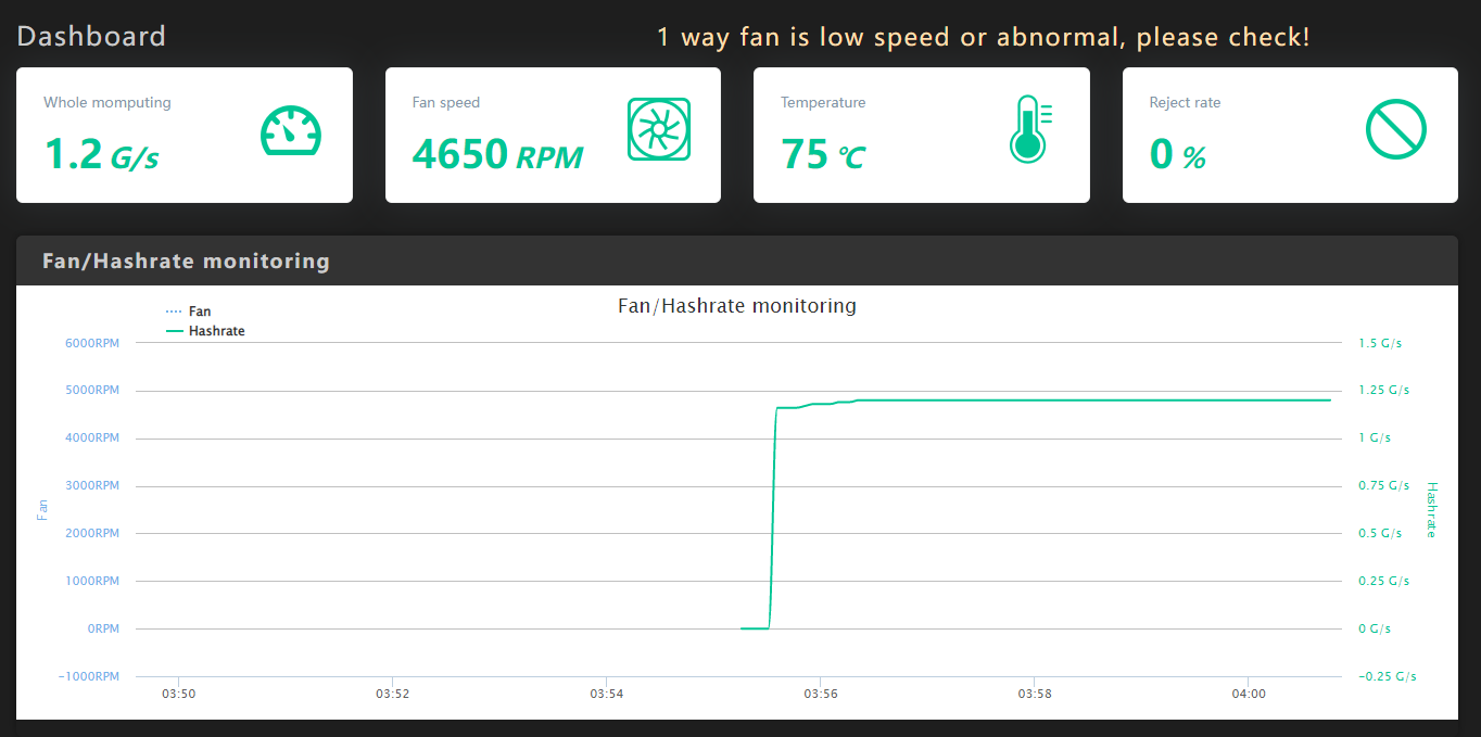

Fun fact: the fans’ RPM reading on miner’s dashboard is fake. I have all the fans removed form my miners as the oil convection alone is enough to remove heat from heatsinks, but on the dashboard I have readings around 4000rpm and changing in real time.

I use a transformer oil as coolant (see the link below to the post with my setup)
immersion cooled mining
It’s been almost one year now since the start and still working great.

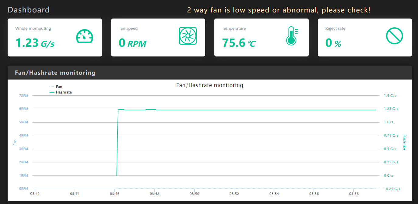

Can anyone please tell/link me what replacement fan to buy to repair the G1-mini? I bought a batch on eBay and a couple units have some internal fans that are failing or have failed. Running ~20C hotter than the other units and bios shows fan speed warnings.
