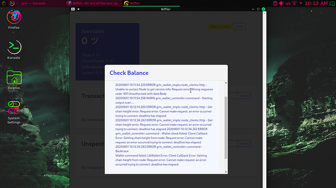

And this is what i see when i check balance.
In my opinion there must be a bug or an upgrade issue that must be fixed… I ve never experience something like this. Whats wrong with passwd login? As the days passing by i need 15-20 efforts to log in and theres no sync. It has nothing to do with my os or firewall rules. Its a niffler problem and believe me its serious security problem especially if there are funds in the wallets. Hope to see soon a solution except telling me that node must be sync. Its not synchronizing.
I read many people experience problems same to me so its not a problem or a connection issue that depends on me

sorry, I found one of my remote grin node does not run properly yesterday.
Now, it’s fixed.
try again
Wallet is running fine for me now! :slight_smile:
Thank you xiaojay! :slight_smile:
Thanx bro! The problem fixed. My transactions are back and the passwd problem gone (remote grin node was the problem for passwd errors)! I also replaced the mw grin version 3.0.0 with the latest 3.1.1 in folder /opt/Niffler/resources/bin/linux/grin where “grin” is the replaced file version 3.1.1
