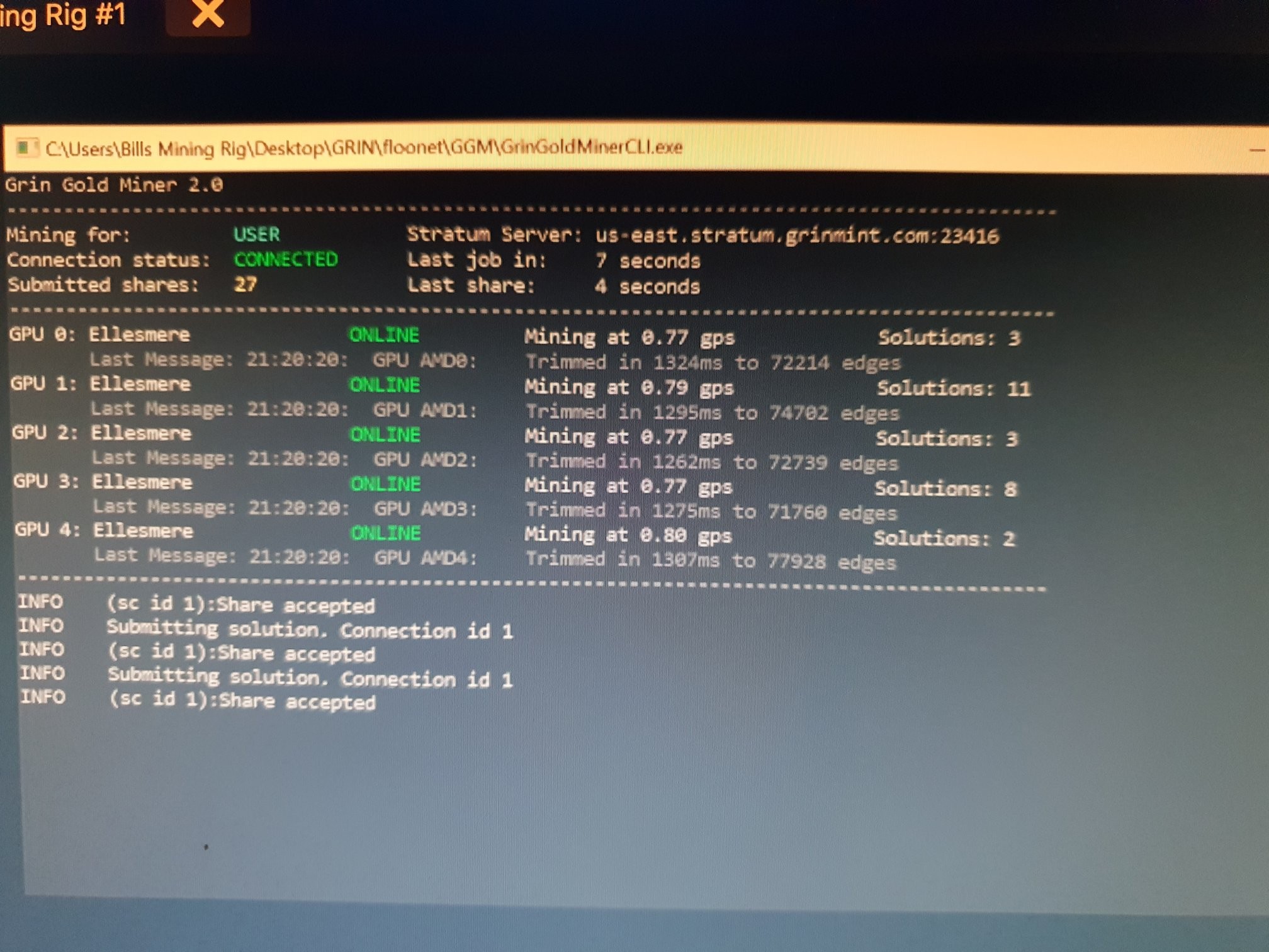

I could get a max of 5/8 x RX 570 GPUs working on my rig.
And the results range from 0.77 gps to 0.80 gps per card.
Nice to know that AMD is also supported, but the results are disappointing
You can call this AMD alpha version. It is likely that we will be able to get it much closer to nvidia. You could say that this is how AMD does when executing code written on nvidia. Donāt expect AMD to stay this slow for long.
