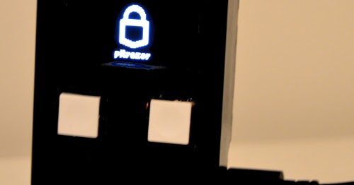

I think it would be more realistic (just less work overall), to find an Open Source Hardware wallet like
Trezor
BitBox (2)
Blockstream Jade
Or another well known hardware wallet and see if they technically (support the right elliptic curve secp256k1, Shnorr signatures etc) can support Grin. Ledger could have been that wallet, not sure why they are fucking up their reputation for nothing with less than transparent services and firmware.

I agree, but Trezor doesn’t have a secure element. Unless you go the approach of Blockstream’s Jade wallet and their “virtual secure element” approach, its a must to have a secure element these days.
So, even if I started with Trezor, I would need to modify the circuit design files to add a secure element.
BlockStream’s Jade is also a very interesting approach and fully open, so I could just build a custom firmware for the Jade, BUT it would require a specialized companion app (instead of just integrating with the existing wallet apps) and an always-online back end service to provide their “virtual secure element” feature. While I think this is a great approach, I don’t think anyone in this community could run a backend service like that without a clear business model. Otherwise, not having any secure element is again a non-starter.
