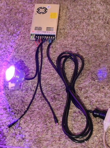

Buy a Mean Well LRS-350-12 which can power 2 miners. If you’re not well equipped to build one I offer it a service with 45+ built so far and they are all happily humming along now.
Here is how they look (with an RGB lamp attached):

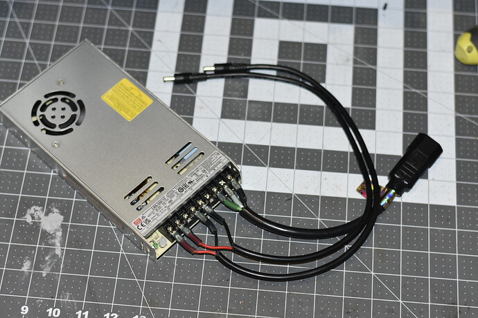

The only thing unreliable about them is the PSU. I build Mean Well industrial PSUs for my miners and they’re rock solid. I use an RSP-500-12 for 4 miners and have 2 more on an LRS-350-12.
I know a lot of G1 minis are coming online this week, and some of you may need new power supplies. I have one brand new Mean Well LRS-350-12 for sale which will power 2 miners for $65 shipped anywhere in the USA. Made w/ 14awg pure copper cabling and Molex heat shrink crimp terminals, they run on both 115V/230V with the flip of a switch.
I can also do custom jobs for those who need more PSUs.
That looks very well made.
Thank you! I take pride in my handiwork, I also have lots of practice after building 50 of them for @Neo-Geo, he was going through cheap power bricks at an unsustainable rate before switching over.
