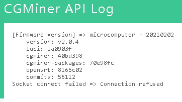

Degraded but at least something. The other one will not mine at all. It boots up successfully and I can login to the webgui but cgminer won’t start. This is what I see in the CGI API Log:
Capture
I’ve tried powercycling the unit multiple times and also going to “CGMiner Status” and clicking “Start CGMiner” but it doesn’t start. I ssh’d into the unit and tried to start cgminer manually and it failed:
