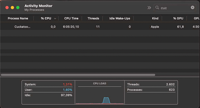

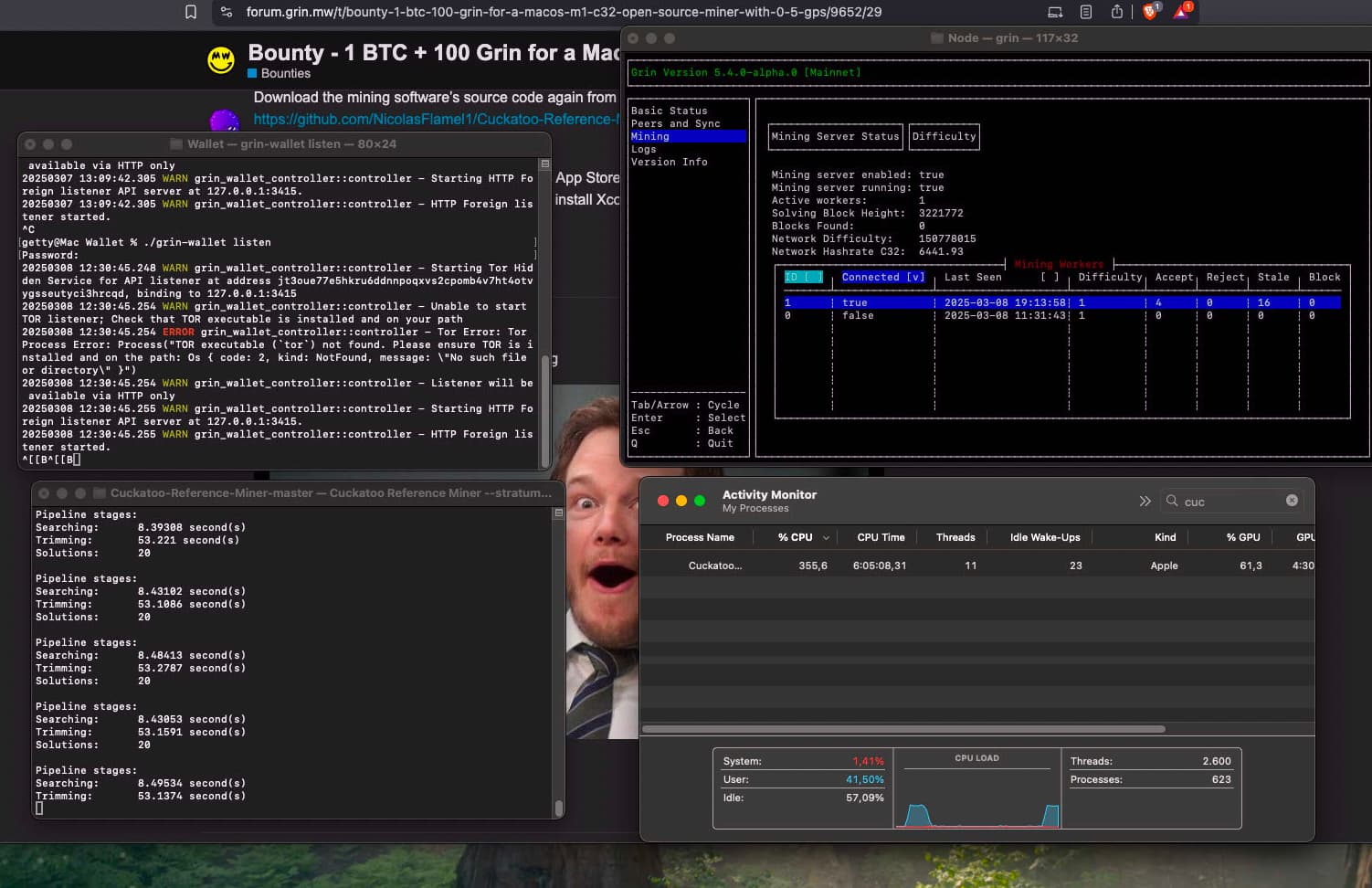

All synced up and I think I’m now solo mining.
TRIMMING_ROUNDS of 25 was used. This has reduced the trimming time but dramatically increased the searching time. What does this mean, and must the values of the two numbers combined be less than 60 seconds to avoid stale blocks? I will keep fiddling.
Connecting to 127.0.0.1 errored but using localhost in its place did the trick, so:
"./Cuckatoo Reference Miner" -a localhost -p 3416
I note that 3 (of my shares, blocks? not sure of the term here) were accepted, so that’s good. But I also note that my CPU idles at 0% and bursts up to 400% (4 cores) at regular intervals. Is this normal? I feel the proc has a lot more to give, ad I’m not sure if it should be working in bursts like this. Thoughts?
As you said most, but not all, are stale.
Incidentally, what are SOLUTIONS? (this number keeps climbing steadily as I mine), and where can I see my graph rate? And does the output of the miner window ever change from this sort of thing?
Pipeline stages:
Searching: 8.38568 second(s)
Trimming: 53.5419 second(s)
Solutions: 20
Thanks to you and others for your assistance.
P.S Was surprised my GPU was doing any work, but appears to be doing a fair bit. Might be able to get more out of it somehow
