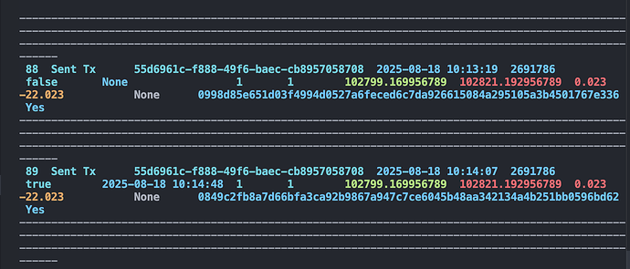

I see 2 TX, and it shows true for kernel 0849c2fb8a7d66bfa3ca92b9867a947c7ce6045b48aa342134a4b251bb0596bd62
but on blockchain I see 0998d85e651d03f4994d0527a6feced6c7da926615084a295105a3b4501767e336
so here kernel changed in-between the receiver got correct one but sender got 0998d85e651d03f4994d0527a6feced6c7da926615084a295105a3b4501767e336 but show as false for confirmed. Doesn’t make sense at all.

I don’t know what happened exactly, but here are some points that could be helpful for you.
  1. If you know how to re-create the issue, report it on grin-wallet github.
  2. Canceling a transaction is local to your wallet, you can’t cancel a transaction that was already broadcasted into the network.
  3. Messy things can happen to your wallet if you cancel an already broadcasted transaction that haven’t received any confirmations yet: Canceling a transaction may result in an incorrect wallet balance · Issue #739 · mimblewimble/grin-wallet · GitHub
I spoke with them and they were running two wallets from the same seed phrase which was most likely causing the issues. It’s a simple mistake I see a lot of new Grinners commit.
But there is no such command as grin-wallet repair I think it was changed to grin-wallet scan (which would scan the whole wallet) but still it didn’t get fixed. I think, as @transatoshi mentioned, it could be related to running the same wallet on multiple devices.
