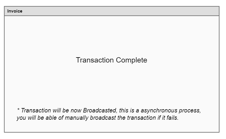

Receiver
The first step is to create an invoice, which again, it is an unsigned transaction agreement too since the sender must agree on the amount to send.
Now, the receiver can share the invoice with the payer or sender. From here, the receiver can either cancel the invoice or continue to collect the payment.
To collect the payment the receiver just need to import the agreement signed by the sender and sign it.
If everything goes well, the payment is collected by the receiver.
Sender
For the sender, things are more easy, the sender just need to accept, add signature and send back the transaction agreement.

More mockups! I’m assuming we add an optional “Manual Confirmation” feature, let’s se…
Transactions
The list of transactions could look like this:
SRS Flow
Since we can now manually accept transactions, we can see a new button: “Accept”. “Complete” is the same as “Finalize”; “Reject” and “Cancel” means that we’re either rejecting the incoming transaction or canceling the unfinalized transaction.
When we click on “Complete” it is the same process of what we know now as “finalize”.
The new thing is the manual confirmation. When we click on “Accept” we are able of confirming the amount and the receiver address.
After accepting the transaction, our wallet will try to communicate via Tor with the sender, if everything goes well, we see something like this:
Well, the reality is that things can go wrong, and probably we could not reach the sender. In this case, we will need to manually share the signed transaction agreement with the sender.
RSR Flow
We could have also invoices. From the wallet we can:
  • Generate invoices
  • Pay invoices
When we generate an invoice, we will have an transaction pending for payment (Payment Requested), we need to wait for the sender to pay the invoice; this invoice then can be manually completed when the sender shares the transaction agreement aka slatepack with us. Invoices can be also canceled.
In order to register the payment, we should accept the transaction agreement signed by the sender:
If we receive an invoice, we have a transaction pending for payment (Payment Pending); we can decide to pay it, but also, we can just reject it.
After clicking on “Pay”, we try to communicate via Tor with the receiver, if something goes wrong, we then should share the transaction agreement manually.
Conclusion
Having both flows together (Sender-Receiver-Sender and Receiver-Sender-Receiver), in addition with manual confirmation for SRS, looks pretty similar. I don’t think it will add any confusion at all, we just need to be less technical and pick better wording to describe the transaction building process. Maybe “Add Signature” is over simplifying, that’s why “Add participant data” sounds a bit more accurate. We can keep iterating until we find a better way to describe things for the regular user. Achieving this will require to define and pass some RFCs, but again, I think it is worth it.
I agree, if done properly, a user will not consciously thing if a transaction is SRS or RSR.
Just a though, if we go for manual settings such as flag for auto-confirmation, possibly setting a threshold for auto-accepting and who knows more properties/settings in the future, best do this on an account level.
So each account uses the general settings, unless someone clicks Account Settings button next to the account and changes them.
If we go with a different signing key (not the tor’s one) then the “accept transaction agreement” view should also show signing key’s public key
I think “add participant data” is a bit too abstract since it doesn’t tell you what data you add and while it’s true that you need to add multiple data, the user should only really be aware of his signatures, that’s why i prefer signatures :stuck_out_tongue:
It would be great if these awesome user flows could be designed in an SDK library. Like each step could be a method.
Then a developer could build their own wallet UI or even include a grin wallet in any number of apps like a messaging app.
Agree, I am in favor of simply using something simple like ‘sign transaction’ or ‘sign and respond’ for the first signature and ‘sign and broadcast’ for the user adding the last signature. As stated before, I am in favor of using a double checkmark system to show the three phases ✓ ✓:
1- transaction unsigned (2 grey check-marks ✓ ✓)
2- transaction signed by one pary (one green check-mark on gray check-mark ✓ ✓)
3- signed by both parties and broadcasted (2 green check-marks ✓ ✓).
Just like WhatsApp, Telegram Signal Messenger or whichever APP nowadays uses. In my opinion we can be both intuitive and simple and still show (although abstract) to the user the steps of signing transactions
I am already picturing an interface that makes it almost fun / satisfying.
Since you need to go through more steps to totally finalize a transaction, you’ll need to do more actions each time you open the app.
Maybe you see the transactions vertically stacked like emails in an inbox. Then you can do things like swipe right or left on the transactions to do actions quickly. Or also do bulk actions.
In this case, I think providing a tool tip that displays an example of what to paste/input would be more helpful (totally bypass the terminology issue).
Ultimately, bikeshedding over terminology is not the most productive thing to do, in my opinion. I think as long as terms are used consistently, and there is an accessible/known place that defines the terms, people will catch on.
For example, the discussion over changing “slatepack” to something else. While some people might not understand what it means, someone with the context that the name derives from Keybase’s “saltpack” would likely have an easier time.
Technical jargon can make things harder to understand for people unfamiliar with the terms, and simpler for people that are familiar. Also, if you change fundamental technical terms, there is either going to be a lot of churn in the code to update words, or a mismatch between explanatory terms and the code.
I love the mockups and takes on making transaction building more accessible. Second the idea that manual_confirm should be optional for people concerned about the transactions they receive.
The explanations on-screen are great for some parts of tranaction building known to be confusing.
After working on wallet code and transaction building, I don’t think it’s worth it to try to make Grin transactions non-interactive (in the traditional sense). It would require fundamental changes to the cryptography used in Grin, and likely isn’t even possible to be fully non-interactive like other coins. Two-round transactions might be possible, but would likely require a significant amount of work (probably not worth it).
Explainers, documentation, and maybe even some games/demos could help people become familiar with how Grin works.
