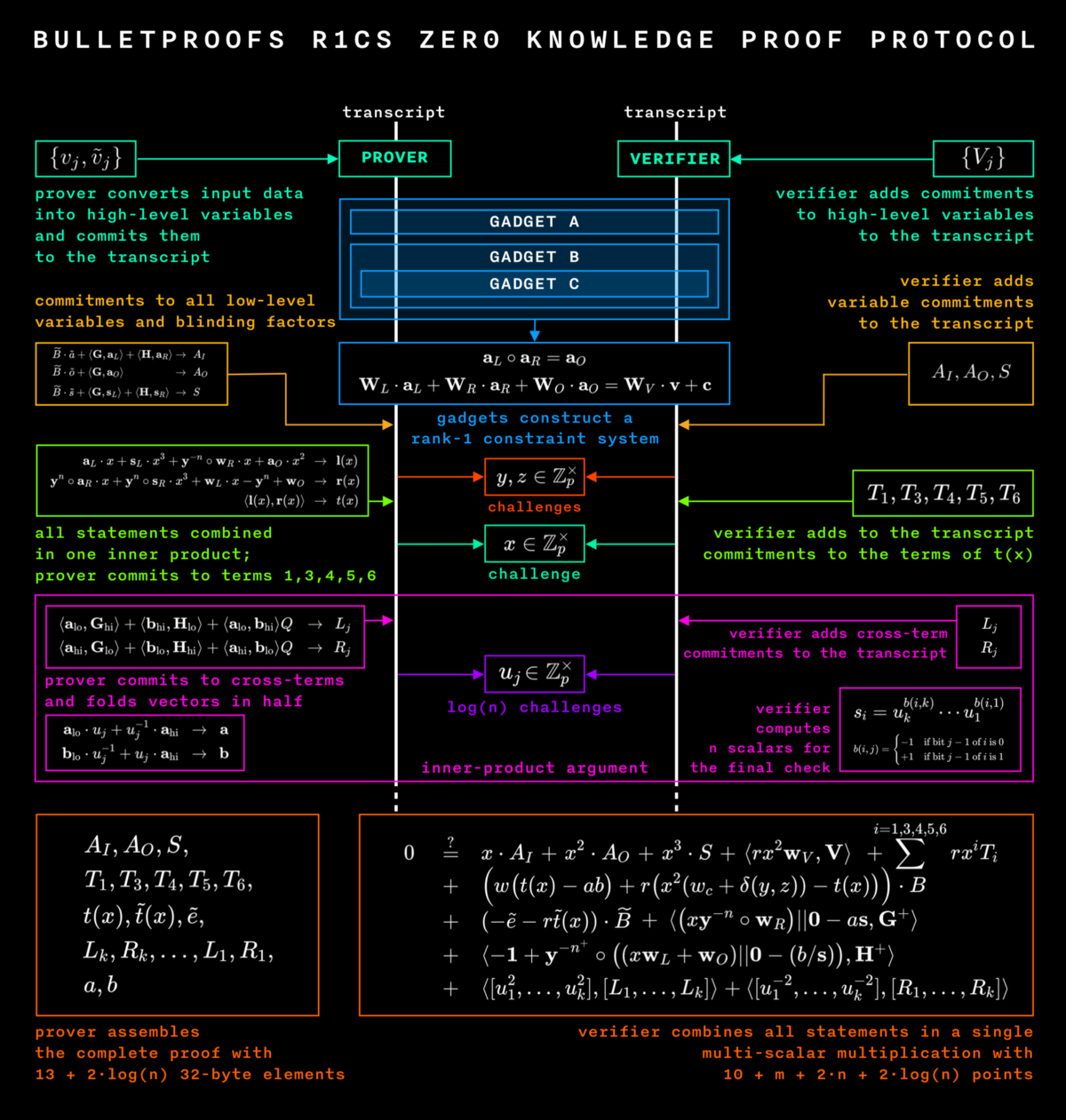

- Programmable Constraint Systems for Bulletproofs
- Cloak protocol, confidential assets using bulletproofs
