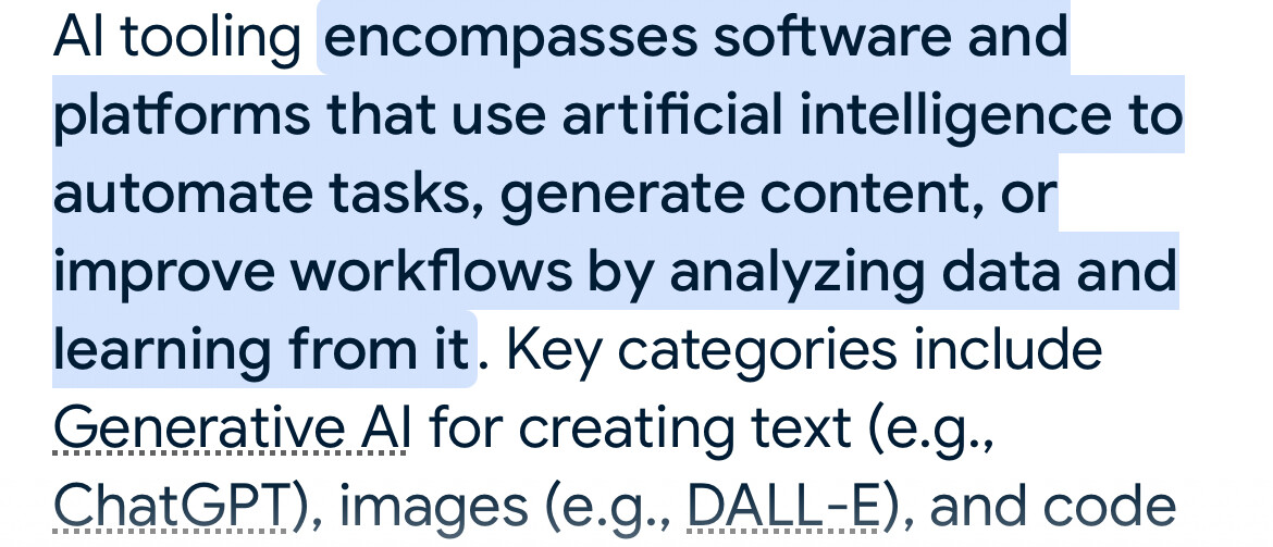

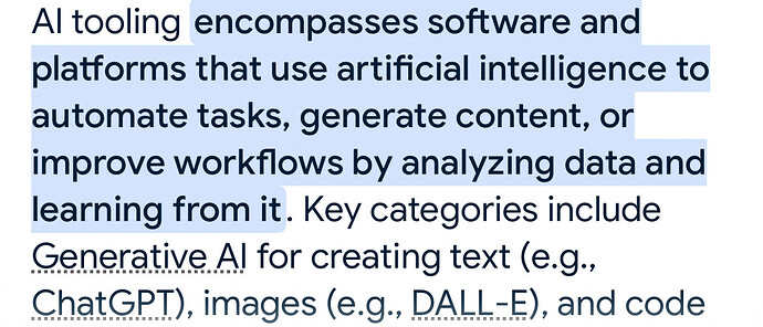

How can you @Yeastplume accuse a guy of producing “ai slop” while at the same time bragging about using ai tooling, which is just fancy speak for ai slop.
just because his ai slop is more soupy than yours he’s a scammer? lol if you say so.
