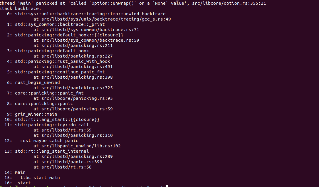

After building and installing grin-miner 1.0.2, i have this error when initiating
./target/release/grin-miner
Thanks,

Run with RUST_BACKTRACE=1 and provide the output
RUST_BACKTRACE=1 ./target/release/grin-miner
What version of Ubuntu? What version of rustc? If you just download the pre-built images, does grin-miner work?
If I run that command from grin-miner directory, I get the same screen output.
If I run within target directory I get this:
rustc version is 1.3.0
Ubuntu is 18.04.1 LTS
Where can I get the pre-built images? Haven’t tried it.
The error that you get when running within the target directory is because there is no “grin-miner.toml” in that directory - a different issue than the one you reported.
rustc 1.3.0 ? Do you mean 1.30.0? Regardless 1.30.0 is kind of dated - it is from October. Current version is 1.32.0 No idea though if that is the cause of your problem.

1GB of RAM will not be enough memory. Try 4GB of RAM. (P.S. Out of the box and not making any changes to grin-miner.toml you are mining with your CPU which is what the output you attached is showing.)
