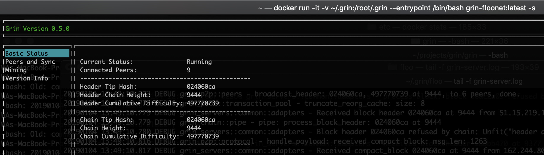

I experience an issue with running the docker floonet container. The container seems to start correctly, it shows it is downloading headers and blocks and connected with peers etc. and then suddenly it crashes. From docker ps -a I see it twice exited with error code 135 “Exited (135)”
It happend twice and the issue occurs after a couple of minutes when the grin status overview (when docker exec’ed into the running container) shows it is downloading headers/blocks and also shows it is connected to 13 (the irony
) peers (see uploaded printscrn).

Running the docker through overriding the entrypoint and command is more stable:
docker run -it -d -v $HOME/.grin:/root/.grin --entrypoint /bin/bash grin-floonet:latest -s
followed by (inside the container)
grin --floonet server run
and now it runs stable it seems:
If it were to crash I could perhaps have obtained more details inside the still running container itself.
