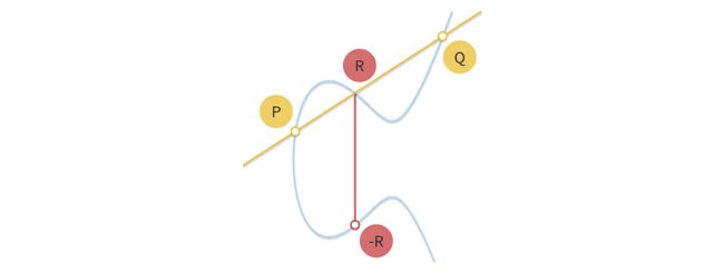

Given three aligned points P, Q and R, their sum is always 0. We treat this as an inherent property of elliptic curves.
P + Q + R = 0
We can then write it as:
P + Q = -R
So that adding the two points P and Q results in -R, the inverse of R.
If we draw a line passing through P and Q, this line will cross a third point on the curve, R (so that P, Q and R are aligned). If we take the inverse of this point, which is simply the one symmetric to it about the x-axis, we have found the result of adding two curve points, P + Q. Let’s illustrate:
ecc1
In other words, addition of points is basically hopping around on the curve to a different, seemingly random point; It looks random unless you know the exact operation performed to reach it.
