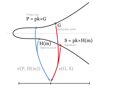

Chia has started a full implementation of BLS signatures:
BLS (short for Boney-Lynn-Shacham) is a newer signature scheme based on elliptic curve pairings that has many attractive features. In particular for Grin, BLS signatures can be aggregated non-interactively, including with different messages. This would allow kernels aggregation, perhaps not in every single case (kernels can still be useful for scriptless scripts) but in the great majority of cases.
