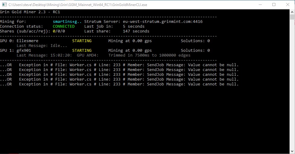

I’m getting the exact same issue as well.
UPDATE: Changed config.xml connection settings and it fixed the issue:
<ConnectionAddress>eu-west-stratum.grinmint.com</ConnectionAddress>
<ConnectionPort>3416</ConnectionPort>
<Ssl>false</Ssl>

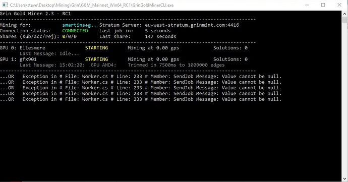

Something is teribli wrong with my config file. 0 compatible GPU’s detected.
How exactly should I edit the file in order to run the miner smoothly.
Windows7x64
Just downloaded the latest version of the miner and here what happens when started. Cuda solver gives me an error : Unable to create kernels
I found the problem - the miner is working only with the crimson amd drivers, so you have to download them. It didn’t work with the adrenaline ones for AMD.

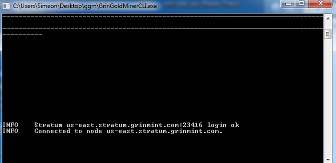

I just finished building a rig, RX580 cards, keep getting Stratum Connect #143# no such host is known. Please help, Thank you.
depending on the miner, you may need to remove the ‘stratum+tcp’ part, or make sure to use the right port…
Thank you so much for the response and help. Wish you all the best.
